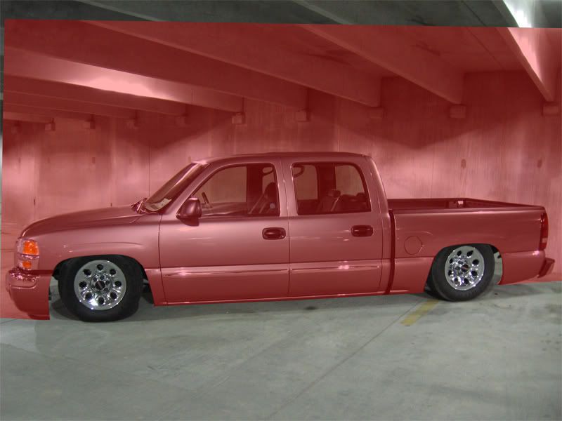

    Here's a pretty rough run down of the processes. I would suggest mostly just playin around with the program A LOT.
    Lowering:
    Select the bottom edge of the body of the vehicle and the background above it. in other words, once you get to the front bumper just go straight outta the screen and include the surrounding background. repeat with the back bumper (assuming your using a 1/2 shot picture). After making your selection, it be best to copy the selection and paste it as a new layer. (Ctrl+C , then Ctrl+V). Then use the "Move" tool to move the body of the truck down on the rims.
    Example: Red area is the selected area

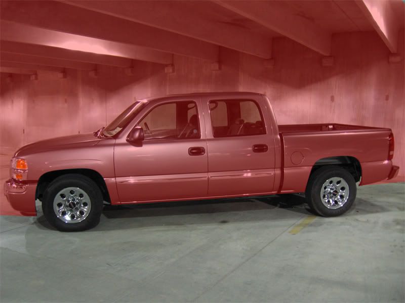

    Then here it is after you move it down:

    Looks like you rotated the selected area as well. I'm guessing to get rid of the rake? I would also suggest adding some mild drop shadows under the wheel wells so it looks more realistic. Nice write-up x2.
