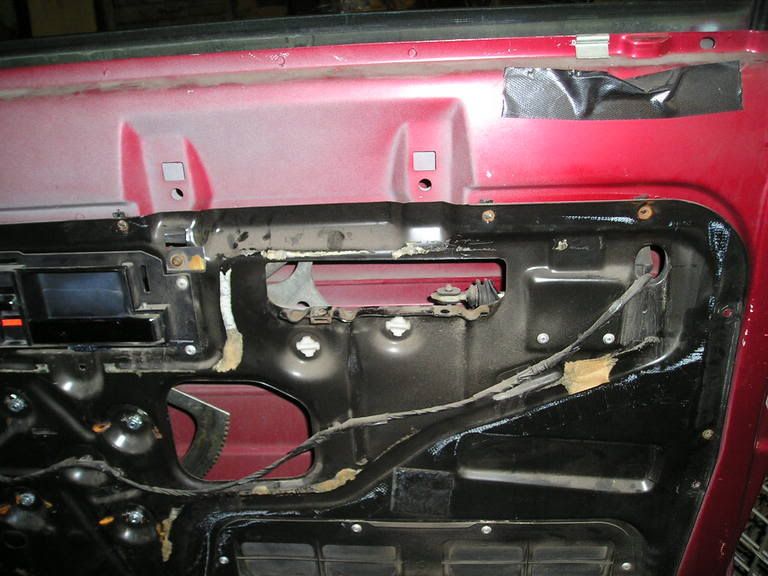

7. This is what you'll see next, minus the duct tape. This is the second time i've done this. and it requires removing the weather shield (but i'll get into that next.). The black metal is the inner door panel and the tan colored paper is weather shielding.
8. Now remove the weather shielding, it's held on with some double sided tape. After you remove the weather shielding this is what you'll be looking at.
