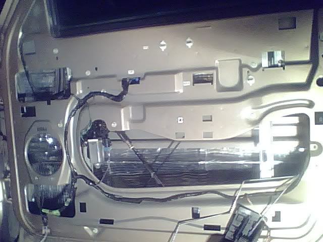

i know, i know i've posted a few of these already but finished the last door today so figured i'd just start another thread.learned a lot from this and the work went tons faster for the 2nd set of doors. took about 12 hours (lol) total. well, here they are in the order that i applied them on..

Your speakers are crying for a baffle and to have that big hole in your door blocked.

M5 beat me to it. Yeah you need to make some baffles. And use some roof flashing or thin galvanized steel to cover it up with self tapping screw. Just deaden the cover individually, so you can just take off the screws and it will come off. My cover didn't cover up the window motor. It went to right before it and stopped. So it is still accessible, but it would be alot easier if I took off the cover. Just buy a 24x24" piece of steel, thats all u need.

completely spaced the baffle, oops.
and yeah going to eventually cover the holes after i replace the mirror motors

Well here are a few pictures I took while deadening with the RAAMMat. You told me to take some so here they are.
Mat inside the door. I put like 3 layers directly behind the speaker. like 12x12 squares.
My speaker baffles that didnt work, because I had some clearance issues with the door panel. I made some new ones but I didnt take any pictures of them, but I did seal them in the end.
All the galvanized steel covers screwed on. I just used self tapping screws. Just covering up the holes without deadener put a big boost in midbass to my drivers.
My door all wrapped up, and finished but without the new baffle on. Well there is the process I used. I only did two doors so far. I still have yet to do the roof.

Keep in mind, reducing the pannel resonance will do very little for your overall sound.
Its when you combine the mass loading with a proper wave baffle, coupling, and sealing of the doors that your speakers will start to shine.

Except removing undue colorations from panel modes which our trucks have a lot of; however, your point about the sealing, coupling will indeed be the cure to bring out the midbass and hop up the midrange clarity.
