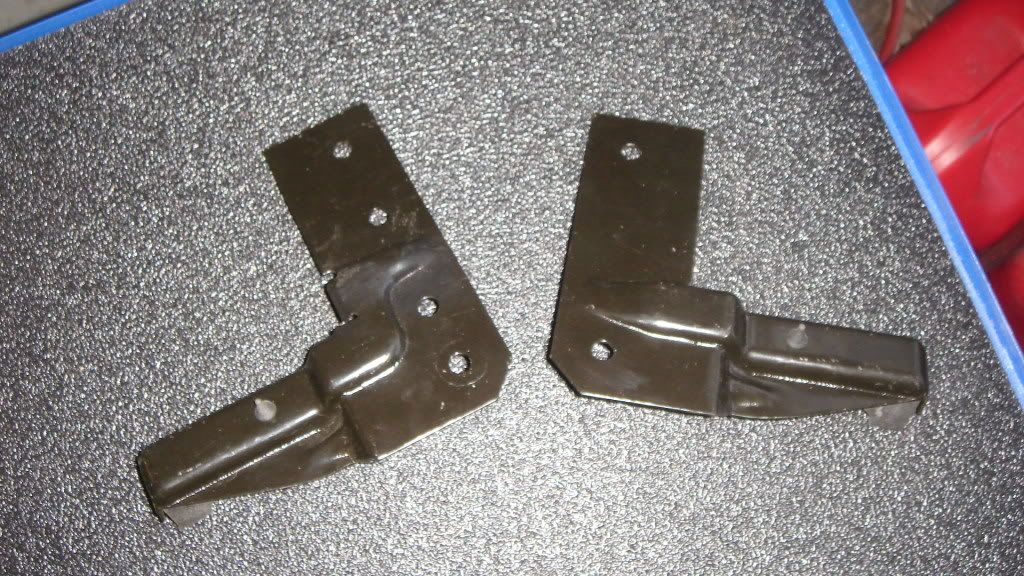

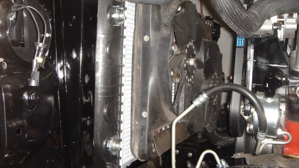

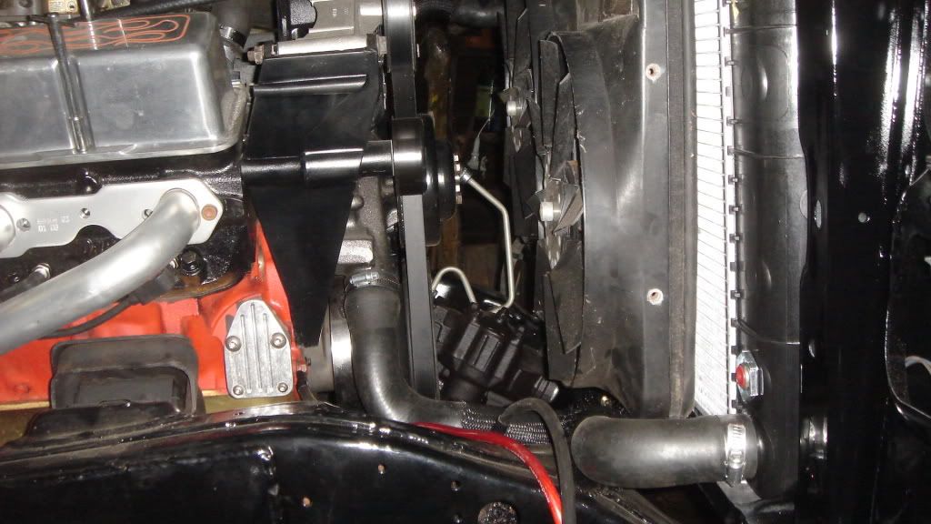

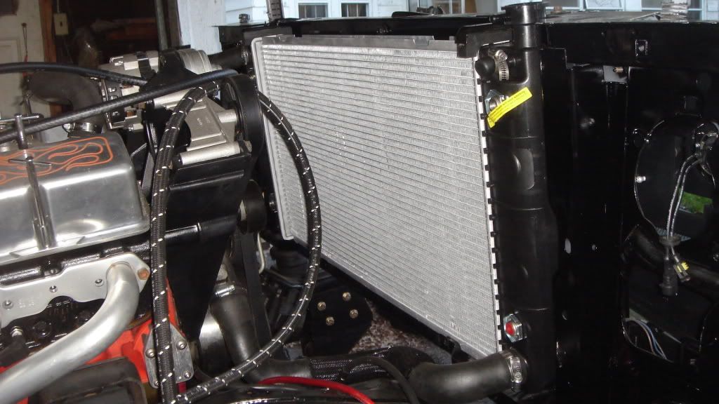

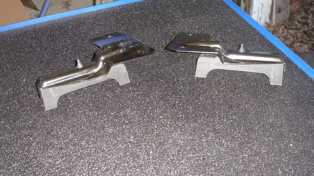

Got the driveline caliper in, now its just a matter of making a bracket to hold it in place
The 94 originally used the fan shroud to hold in the upper part of the radiator. Since I am running E-fans, I found a set of upper rad mounts from a 96 burb that will work perfectly.... to bad i had to get the 34" radiator to fit the mounts then. And after all is said and done, a set of rad bushings from a 93 HD truck will then tightly hold the bastard in place.
Started mocking up the fans so I can get them all cleaned up, and make a nice set of aluminum mounts to hold it firm in place
Nice amount of room still
