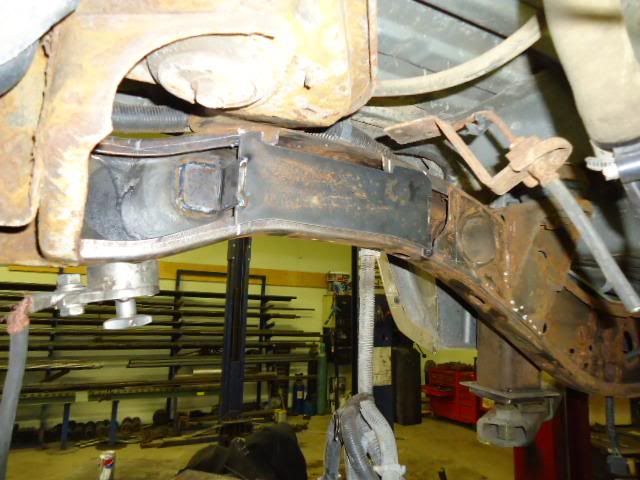

the back of the truck had 3 cross members that were all in the way. with a panhard mount, shock mounts, winch mount, relocated gas tank mounts, and general frame strenghening support needed, it all had to come out and be redesigned.
old x-members
and removed
this x-member actually held 2 of the rear body mounts...more on that in a bit
the frame was plated in where the new x-member will live. the front and the back of the frame was tied together using L-shaped gussets.

here is the x-member being test fitted and it shows how the pass thru's for the body mounts work
jacked into place and marked where it needs to be clearanced for the top corner of the tire under full articulation
cut lines marked
and cut with a cordless Makita saw. Clay says it zips thru 1/4 plate like nothing. i gotta get one of those...

x-member full welded in
