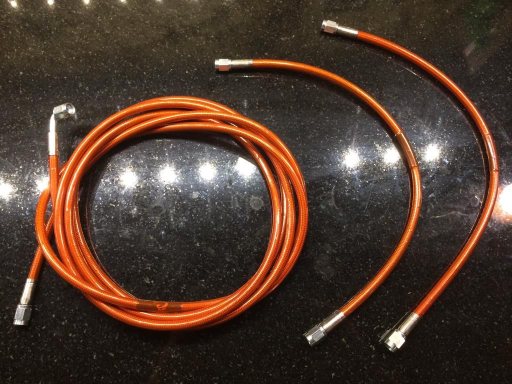

the ARB for the front nightmare continues. maybe 3rd time is a charm... in the meantime, i had Crown Performance make up some super badass -3an airlines for the lockers. 2 long lines from the axles that reach under the passanger side rear seat and connect to 2 -3an bulkhead fittings. the 2 short lines run from the inside of the bulkhead fitting to the solenoids. i will also have 2 shot lines that route the vent side of the solenoid back outside to eliminate the WOOSH and possible oil spray in the vehicle. my turbo bike also has all Crown lines on the brakes and clutch.

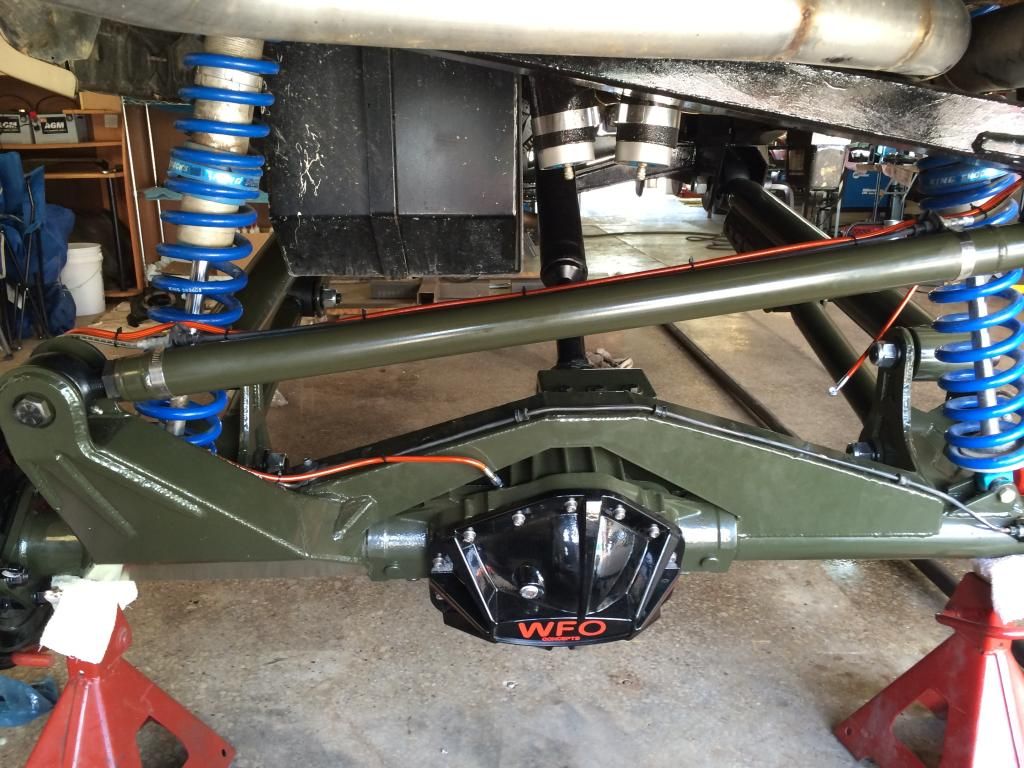

front diff is assembled, ARB and 5.38 gears on board. its hanging and waiting on the hardware for the trac bar to be done at the nitriders. also waiting on the front airline from Crown performance.
ive read about guys having big problems with the yukon locking hubs being hard to engage, but these are smooth as glass
